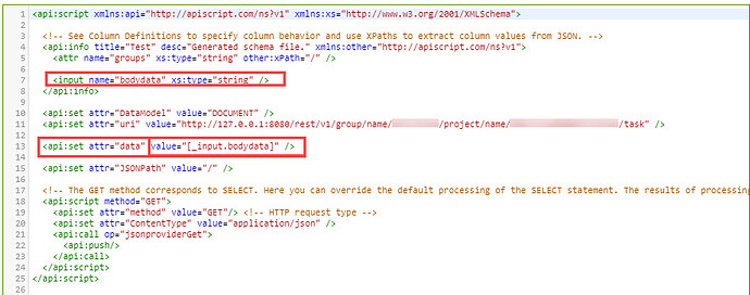

Hi @Austin​,
I haven't implemented this exact scenario before but this should work fine from what I can tell. You would edit your Query Profile to include and input which will allow you to pass in the content you want to send in the body and then use the input in the "data" section for your body. So it would look like this:
When you go to call it with the API Query you would use the Advanced method and specify the query. In the where statement you pass in the the body information:
Let me know if you need more information to get this to work. Thanks!

Hey @dba1620282579220​ ,
I passed it through a custom SQL query when I did this.
First step is to select your API Query component and change the Mode to Advanced so you can add a custom SQL query.
Then just add your custom SQL query to assign your variable. So using my/Bryan's example above you would do:
SELECT * FROM Test WHERE bodydata = '${myvariable}'
Test is the name of your API Query Profile, bodydata is the input attribute your API profile is expecting, and myvariable is your variable with the JSON.
Hope that helps!
Austin
