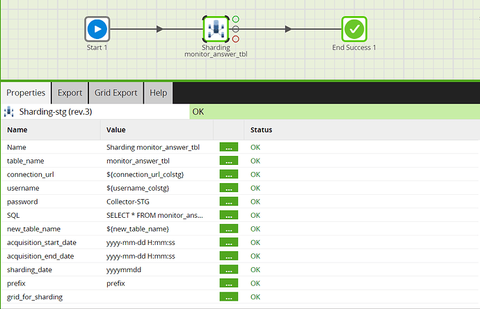

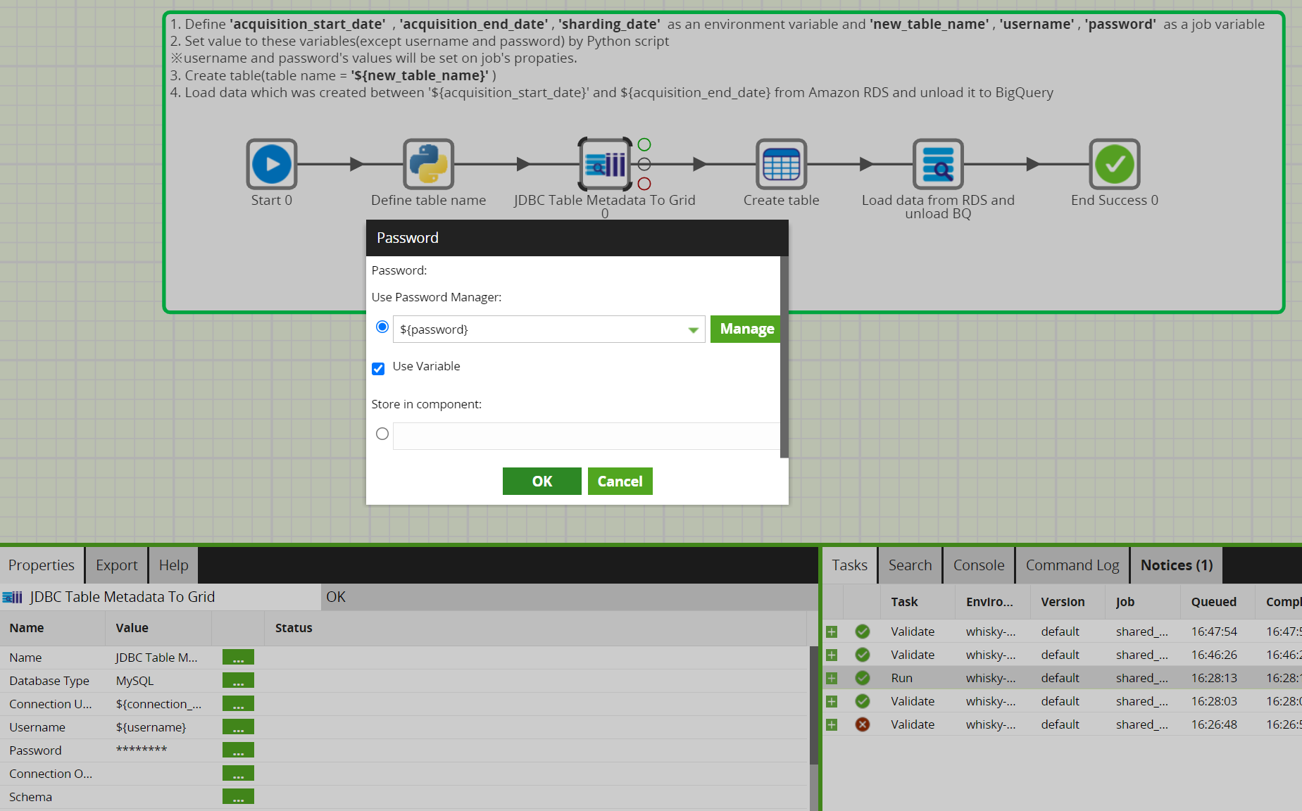

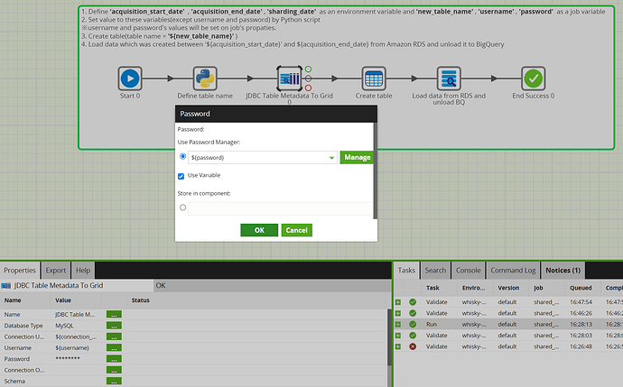

Like the image below, I defined password as a job variables and set ${password} to password's property on JDBC Table Metadata To Grid component and Database Query component.

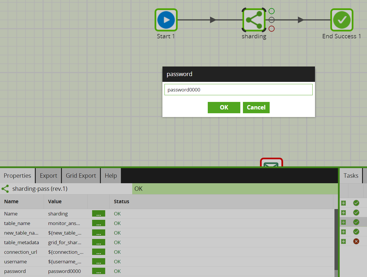

Then, I generated this job as a shared jobs and when I use it on some orchestration job, I set password to password’s property like below.
After that I run this component and it shows error message like
“Parameter Validation Failure: Password - Unrecognised password name [password0000].”
Even though the username was success(I gave value as a variable to username but it doesn’t matter), somewhat password shows error.
I guess that password should secure safely, so I need to use password manager, but there is a choice that I can check “□use variable”, so I am confused.

I could solve this problem and this is absolutely my fault because of ​my ignorerance.

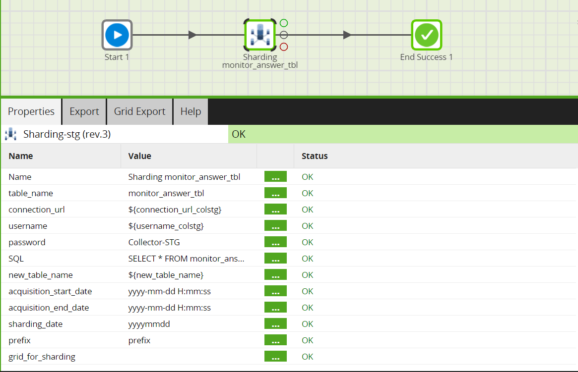

AS I posted image, I gave ${password} to the password property and then, when I use it as a shared jobs, I should give value which is stored in Password Manager to the password property. (Collector-STG has a password for connecting to database)
