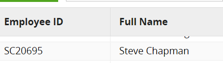

I want to replace certain values, for example changing a name from Steve to Steven. WHen I tried map values, there will be another column added to table (value can't be replaced in current column).
Is there any suggestion to replace value in the current column?
