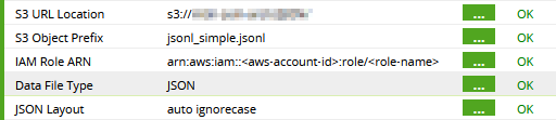

So in Matillion ETL for Redshift you need an S3 Load component, and just switch it to JSON mode like the below screenshot.
With your file I also had to set the JSON Layout to auto ignorecase because the fieldnames are initcap. Redshift tries to map the keys in the JSON objects to column names. Without "ignorecase" it finds "Employee" but won't map it to a column named "employee", so it creates records but silently does not actually set the column values.
