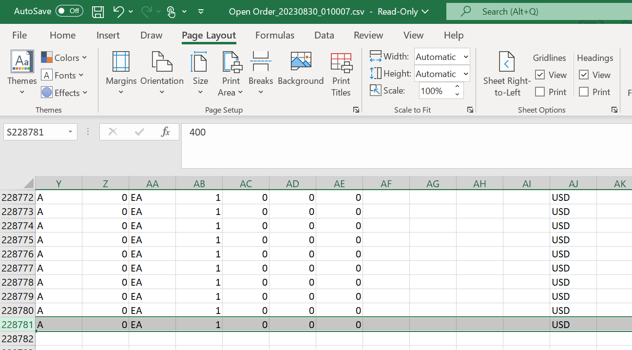

Even though the uploaded csv file has the exact same size as the original one, the number of rows is different:
0694G00000USBNsQAP_0D54G00009bUgkASAS
In the image above the former one is manually downloaded from SFTP and the letter is downloaded from Blob after it was uploaded using Matillion.
Please guide me through this process in order to figure it out how to solve it. Thank you!
Just because occasionally Excel does weird things. If you open the files in notepad++ (or another text editor of your choice with line numbers) do they also show different numbers of lines?
Are all the rows the same width? E.g. has there been some kind of cr&lf issue and some rows are actually 2 rows jammed together?
Indeed the issue was with the way Excel opened the file. Thank you!
