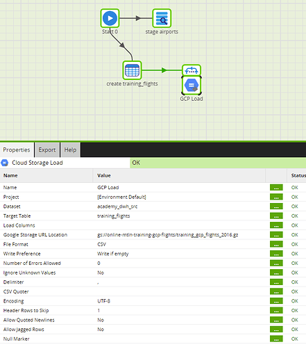

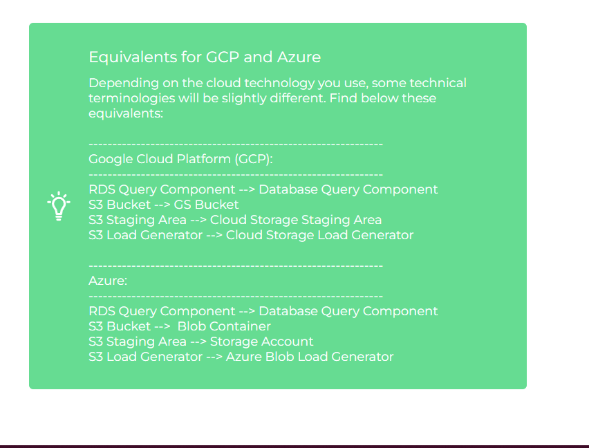

We provide a note on the Academy for our Google BigQuery product (see green box below). Please, also find below a screenshot where you can check how the variable name can be added to the 'Google Storage URL Location' property of the 'Cloud Storage Load' component.
Thank you for your feedback and we hope this helps to continue with the course. If you need anything else please reach out to us.

I did this whole thing twice to make sure I wasn't missing anything, or wasting your time, so I would suggest its not obvious enough for a normal person! The screen you're showing me, is from section 1.... I'm on the second part of section 2 which only shows this - that is why i was confused. Everywhere else in the course up to that point, the guidance is on the same screen you're on.

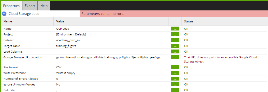

However having said that, I DID try what they suggested but I get the following error when I do.
