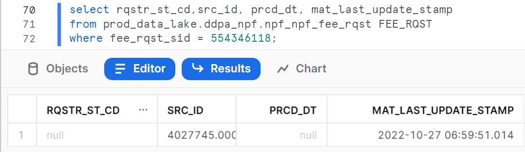

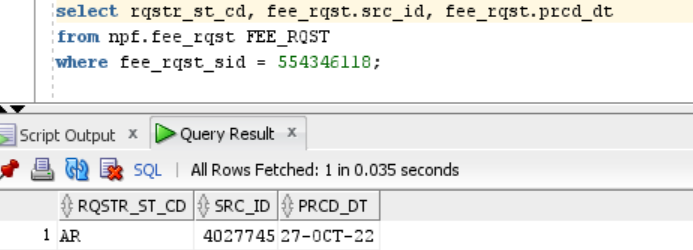

We are running into an issue with our CDC jobs that is causing data to not be replicated accurately to our destination. Please see the details below.
Source DB: Oracle RDS
Target Database: Snowflake
Source Data:
Target Data:
Note the difference in RQSTR_ST_CD and PRCD_DT between the source and target tables.

The next record is flagged for an update with an additional field populated because an additional field is updated in the source. But this time all other fields are now NULL.
So in our target table, after the record is inserted and then updated the only field we see populated is SRC_ID.
