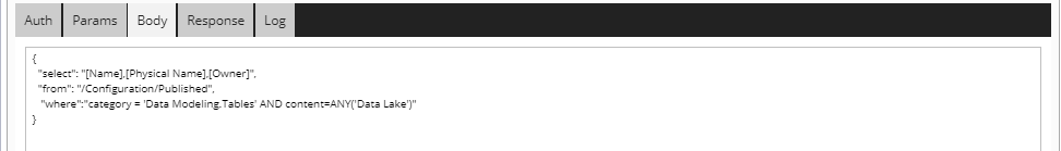

Third, enter relevant BODY that will form the MQL query, example below:

The next API Extract components then connect to the aforementioned Extract Profile (selected in API Property). In the API Key Value properties I resolve the job variable that holds my authentication token. I pass in the body request which is formed of MQL hitting the executeMQL endpoint. More info on MQL - http://metaintegration.com/Products/MIMM/REST-API/mql.html
