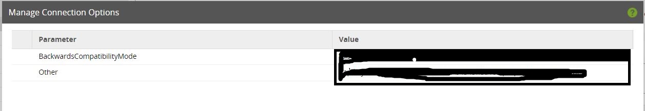

One other thing I just thought of is that anything with _connection.XXXX always means that Matillion's API Profile is expecting the parameter to be set via the connection. Meaning, you would need to set whatever hapikey is to a value at the time of the connection which can be done in the API Query component under Connection Options. I am not familiar with the hapikey attribute so I suspect this is a custom header attribute that the API you are using requires. That's a complete guess without see the API Profile Perhaps you can post your raw API Profile here minus any credential information if it's included. I can usually look at the API Profile and know exactly what is going on.

Yes, you are right: I needed to set the connection parameters in the API Query Component which I figured out by trial and error.
Your explanation makes much more sense of what I did. Thank you very much, this is so helpful.

Hi Ryan,
I copied the parameter info from the API Query profile and added them in the API Query Component. You get the Parameter details in the rsd file in config tab.
You need to add the same details in the API Component, in the Connection Options and that should solve the problem.
